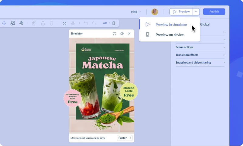

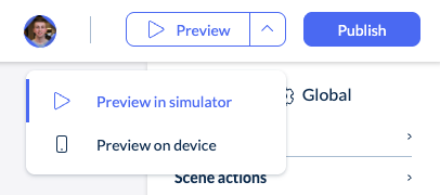

Open any project and click the arrow next to Preview to choose "Preview in simulator". A window appears showing your experience, staged and ready to test.
![Screenshot 2026-09-21 at 14.53.47](https://updates.zap.works/hs-fs/hubfs/Screenshot%202026-09-21%20at%2014.53.47.png?width=406&height=180&name=Screenshot%202026-09-21%20at%2014.53.47.png)
For image and world scenes, the simulator places your content in front of the camera automatically and lets you see the tracking in a 3D simulation. For face tracked scenes, it shows a sample video of a face so you can check placement and sizing without needing your own webcam.
As you make edits in Designer, the simulator updates, so you can leave it open while you work rather than reopening it after every change. Use it to quickly check layout, content, timing and multi scene interactions. When you're ready to judge how tracking actually performs, whether your printed image target locks on well or your world tracked content sits at the right scale, that's when it's worth switching to on-device preview, since that's how your end user will actually experience it.
